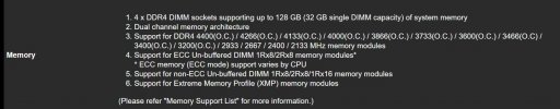

I am hoping someone here can help me. I built my system about 2 years ago. Its a fairly high-end machine as I do 3d modeling, renderings and animations. My mainboard is a Gigabyte X570 Ultra. I currently have (2) 64GB modules of RAM installed. The RAM is Corsair Vengeance LPX DDR4, 3600 MHz 18-22-22-42. I am having crashing problems with my rendering engine and I have been advised that I need to upgrade my memory as I am using a lot of 8k textures. I want to add 64gb additional to this system, which will get me to a total of 128GB, which my board will support. The first image below is a screenshot from Gigabytes website showing supported memory. My question is, I first want to be absolutely sure the current RAM IS compatible with this system (I have been using it for 2 years with no problems outside of the rendering problems). IF this memory is in fact compatible, then problem solved, I will order 64GB of the exact same RAM to add in. Where I am getting confused, is the screenshot shows the 3600 but it says "O.C." is that overclocked? Is that good or bad? I really want to be sure this ram is correct before ordering another 64GB. A hardware guru helped me spec this system back when I built it, thats why I got this RAM. I hope this wasnt too long. Thank you in advance for any light you can shed. The second and third images I am attaching are pictures I took of my RAM modules currently in this machine. Not sure if this matters, but this is an AMD with an AMD Ryzen9 3950X 16 core.
It just means that the motherboard only natively supports memory up to 2933mhz. In order to use memory above that speed you have to enable XMP setting in bios to physically over clock the ram to that speed.
