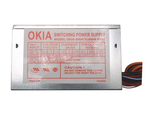

Wowzers!!! The 5v rail there is enough to cause stability issues ... whats the make/model of that PSU? :)
i know that the ones that come with cases are usually crappy, but this one just looked good at 500W.
wattage doesnt mean all that much ... the strength 12V line and stability of the rails is far more important .. at 18V, the 12V line isnt exactly spectacular and from experience you notice that the stability of the rails isnt exactly superb either.
PSU 101.
ok, well, im thinking your correct, because yesterday i started up my computer at 2 difference times, and both times it worked, and then i turned it on this morning and it didnt. i'll think about getting a new and better power supply.
that one has horrible reviews
im lookin for something under $30 shipped.

edit: well, i was wrong, you were right, it was the power supply. but the important this is that i finally got it to work! i just exchanged power supplies with my old dell 2350 (discontinued, lol) and everything works fine. thanks for your help praetor!
