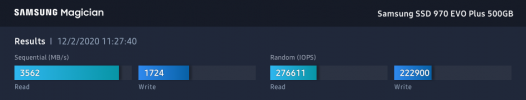

Here I did a few more test and all of them arre very interersting... and frustrating.
Test 1: In this case I thought I should try my maiun NVME m2 Samsung EVO 970. Which has a max speed of 3500 MBs. I have this drive in my pc among with two QVO previously mentioned.
Here comes the catch again... when transfering from my QVO to the EVO 970 it also starts sweet constant rate of 550 mb, after 2 minutes, drops down to 70MB again.
Test 2: Just to make sure, I tried also from a WD BLUE SSD to my 970 EVO and the samme occurs. Now I know its impossible the write speed of a 970 EVO can be 70 MB... this just doesnt sounds okay. And I know its not the WD BLUE as I use that to record 4 K video, and I can record continuously at a rate of 240 MBs until I fill that disk... so it has to be something else.
Test 3: I transfered to my 970 EVO from my Sandisk extreme pro uhs-II (300 MB/s) a card I use to record also, 4K video and which I can record non stop until is finished... and again, we start with a nice transfer of 280 MB and afterr 1 or 2 minutes, back to 70 MB...
Test 4: here comes the most interesting part.. I have a second laptop from 2014, i5 8gb ram, and I upgraded it with a WD Blue SSD... when transferring into that laptop there is no transfer speed drop at all.... hence my reason to belive it has nothing to do with drives as I tried, HDD, SSD, NVME, and SD CARDS, all giving the exact same results and transfer drops go exactly to 70 MB/s....
Thanks again!
