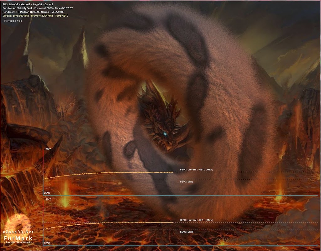

Ok so maxing out settings on FFXIV (all except Ambient Occ and Depth of field because thes are FPS killers) my computer mad lags.... So I decided to try to OC again on the new carD! Heres my furmark (actually at 12 minutes now same heat about 66) does this look good? Should I try going to 900 Mhz? I dont want to get into the unsafe zone, ive got like 9 fans in this thing! haha.
THx

I got the snowboard, that post is super old, haha. Im playing at 1900/1080. In town around people im runnin about 30 FPS, outside 45-60 FPS, when i OC to 5870 speeds i get no FPS increase (FYI I redownloaded the drivers and having better results but still seems like it should be better).
EDIT: I think its 1920/1080

If you aren't seeing an fps increase at all from OCing, it is something else holding you back. What is CPU load when in crowded areas?

That HD is getting a smashing. I would recommend a HD as this is almost always the biggest bottleneck, but seems unlikely to cause FPS performance issue.
I would also check it in a more demanding game, the one on the screenshot looked like 2006 Halo. Get crysis running or 3DMark11 and then check CPU, i agree, its the next most likely thing.
Either way, new SSD or defrag regularly.
